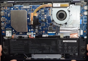

My laptop has this issue where it refuses to use the battery. When the adapter is connected, it runs completely fine, it detects and even charges the battery.
However, the moment I disconnect the adapter, the laptop just shuts off. In this state pressing the power button does nothing. Something weird I found, is that on battery power, while holding the power button, the laptop will actually power on and start booting, but the moment I let go, or once it triggers a reset (because I held the power button for 10sec) the screen goes black again.
I already replaced the battery (previous one had around 60% health, new one shows 99% health) but that didn‘t work. I also updated the bios and my OS with no luck either.
I would GREATLY appreciate any help, thanks )

Since it is a new battery showing 99% and the computer otherwise works normally from the charger,
The power management IC it responsible for switching between charger and battery power.
A laptop will run from charger power first and switch over instantly if charger power is lost.
All of that circuitry is in the power circuit, which might be integral to the MB or a separate daughter board.
Based on this picture from this video, that circuit is on the MB around the battery connector (red white and black wires).
Repairing that at a component level would be very difficult because u would have to first determine which component is at fault, then replace that on a very crowded SMD
circuit board. You can try to do that, replace the MB, or just continue to use it plugged in.

Sounds like something in the battery power circuitry isn't working properly. Even even it's charging the battery, it may not be able to use battery power to operate the system. It can detect the battery and charge it, but many times there is some kind of gate or component that merges power from the battery into the main power line. My guess is that's where the fault is.
I don't have schematics at hand for this specific model, but I would wager this is an issue with the board if you have already replaced the battery. It's possible the new one is a dud, but I am less likely to think so if the symptoms are exactly the same. Can you confirm the model of your laptop as well as if there are any part numbers or model numbers on the system board itself?
My laptop is the Asus Vivobook Flip 14 (TP412FAC). The board also has TP412FAC MAIN BOARD R2.0 along with some Chinese letters. I don't know if this is relevant but it is made by Askpcb
