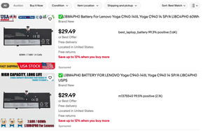

Where can I find replacement batteries for this laptop?
Where can I find replacement batteries for the Lenovo Yoga C940-14"?
Hi @anishkacampbell
Below is an image showing the Lenovo part numbers for all the batteries that are compatible with the laptop.
Search online for the part number only to find suppliers that suit you best. The battery part number is on the battery in your laptop if you wish to verify that the replacement is compatible before ordering it.
Here's the maintenance and service guide for the laptop.
Go to p.32 (38 of 70 pdf) in the manual, to view the procedure to remove/replace that battery in the laptop.
(click on image)
Not sure what country you are in, but it seems eBay has quite a bit of listings for that device's battery.
