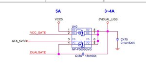

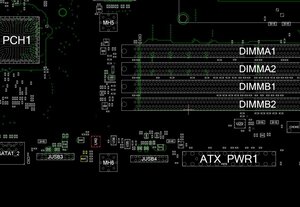

MSI Z390-A pro motherboard.
Near the screw hole there's an 8-pin missing. Can someone confirm if UP7549PRA8-25 is the correct chip. Or a reply with what's written on the chip will be highly appreciated 🙏🏽
@nkatekom the part missing is references designator U40 which is a P5003QVG N&P-Channel MOSFET in a SOP-8 package. Here is the P5003QVG UNIKC Datasheet for that.
I can't find anything on your UP7549PRA8-25 so I can't speak to that.
