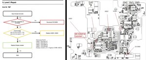

Touchscreen is not working
The phone can turn on, but I can't open it, touchscreen isn't working
Which model? Has it been dropped? Liquid damage? We need more info.
Samsung A52, yes it has been dropped, no water damage
Hi @memelaughsalot
Here's a composite image from the Galaxy A52 service manual showing the Touch Screen not work troubleshooting flowchart and the board location of the components mentioned in the flowchart.
I've included their part numbers as well in case a component is faulty and needs to be replaced.
