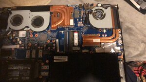

My son plugged his clevo laptop into the scooter charger and it’s blown the little chip / capacitor/ doide/ resistor ect ect on the main board , the battery was goosed anyways , is they anyway to hardwire the charger into the laptop ? All help welcome pls , thx Shane

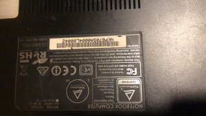

What is the model number of the motherboard (printed on the board) and the make and model number of the laptop (if you can't find the board model number)?
Was the laptop turned on and working at the time this occurred?
As far has I am aware it was powered off because the battery I goosed , where would I find the model number , ?

@bowmeat picture 1 and 2 are a bit to close. We need to see more of the surrounding area as well as the reference designator (those white printed numbers and letters). See if you can get a little better focus on the images :-)
If it says EML5 right next to the component then it is a HCB2012kf-800T80 EMI/RFI Filter (Ferrite Bead Inductor). Essentially you are looking for a ferrite bead filter (inductor) 80 Ohms, 8A max rated current in a 0805 package. kind of hard to find due to the high amperage but you do have some wiggle room. You can always go a bit higher. Something like this will work but it is a 0.2mm shorter. You will need to bridge that small gap with your soldering.
It's doable and not as complicated as it seems. It is also relatively inexpensive. Of course, you can purchase the component from wherever you have easy access to. I just use the company in the link a lot and know what they sell. No kickbacks involved :-)
To work on your computer and to scope out the rest of the circuitry, if you ever have the need to do so, use the Cleevo P670SA Service Manual which does include the schematic.
