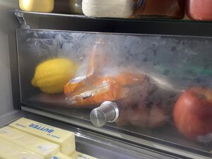

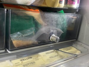

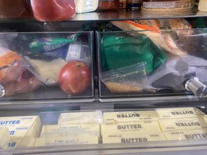

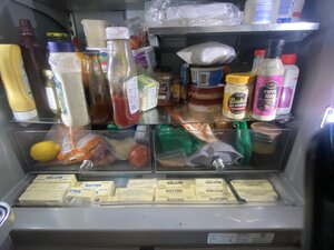

Update: I added more pics of broken plastic attachment on each far end of the frig.
Anyone know what the part name or number is for this Frigidaire refrig piece in the picture? It holds up and separates the glass shelf from the meat and produce drawers. It broke some time ago and I noticed the glass sagging with the food weight and thought I better try to replace it. The model is krmf706ess01 thanks

It's not clear to me from your pics just what part your looking for. Try this link to a parts page for this fridge. You may be able to find a part number for the part you need.
https://www.appliancepartspros.com/shelf...
