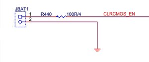

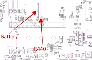

@lennart70551 the official CMOS battery holder for your motherboard is a H1X2M_BLACK-RH and MSI pat number is N31-1020151-H06 I just did a "quick and dirty" search for that but those do not seem to be readily available. Since your battery is a standard hook up
you could try and fit another battery holder in its place. Of course, you could also just use a battery that has an external connector. Cut the connector off, connect the ground to ground on your motherboard and connect the positive from that battery directly to R440 (right next to the positive connection of your battery holder).
No matter which way you want to go, all of that will require some soldering.
