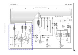

Witam serdecznie. W moim Lexusie rx 300 z 2003 roku są światła "skandynawskie", tz świecą się światła mijania niezależnie od pozycji włącznika. W serwisie Toyoty nie umieli wyłączyć. Pomoże ktoś? Proszę . Pozdrawiam Hubert

Hello. My 2003 Lexus RX 300 has "Scandinavian" headlights, meaning the low beams stay on regardless of the switch position. Toyota service couldn't figure out how to turn them off. Can anyone help? Please. Best regards, Hubert
@hubertmichalak that is the "Daytime Running Light" (DRL) feature and can not be turned of by usual means. There will be a DRL voltage dropping/reducing resistor mounted under the battery bottom plate. You would need to unplug that. You could also look for the DRL transformer which should be in a black box with yellow warning such as "Caution Hot". Unplug the wire that connects to that box.
