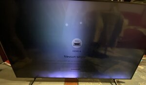

Hi, I got this Samsung TV 65” (QE65Q60RAT), the bottom 5cm got in contact with water after a flood.
Before testing it, I left it to dry for some days, unplugged, and checked for any signs of corrosion by removing the back panel.
When I tested it the backlight was very dim in different spots
Is it worth it to fix it? What should I check for?

Did you also check for corrosion on all the accessible cable connections i.e. remove cables and check cable pins and connectors?
@francesco50625 your TV shows burned out LED's on the backlight strips. For your model you will need two of them. Total cost will be about $20-$40USD depending on where you purchase those from. Since I do not think you can replace your TV for that cost, it absolutely is worth to be repaired.
