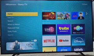

The capacitor C118 on the left half LCD driver board appeared to be short.
Removed the shorted capacitor C118. It looks messy.
C119 doesn't look to be short now. I checked using the multimeter
The TV is working without any issues.
The YouTube videos below helped troubleshoot the issue and fix it. Followed the same steps
