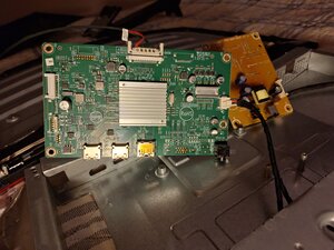

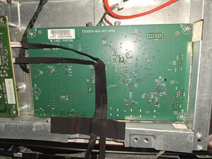

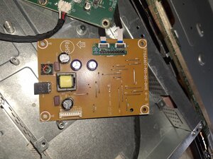

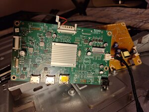

Update (09/27/25)
Hey there,
I Managed to take some pictures of the main and powerboard. The latter has a bit of a darker brown area close to the biggest component on it. Cant really conclude anything on the mainboard.
Im going to reconnect everything screw the boards back, peel off the black tape and start poking the area's you told me.

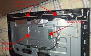

Take a good look at your screen. Do not let the "green " light distract you. That is only the backlight that has turned on. What you do not have, is a video signal. Check the lines on your display that I've pointed out with those red markers
I am certain that those correspond with the CoF on the LCD driver boards ( the "plastic ribbon cables" that connect the driver board to the panel) You will need to disassemble your monitor and check those to make sure they are still adhered. Also check the board itself for any damaged component.
This monitor does not have a dedicated T-con board. The T-con circuitry can be on the main board or the T-con IC is on the LCD driver boards. Best case scenario is a bad FRP ribbon cable, worst luck is a failed driver board. Depending on what you find out, you could try a tape off and see if that makes a difference. If you just want to change something, I would go with the main board, but only if you can get it cheap and have a chance to return it.
Let's see those boards. Post some well focused close ups. Maybe we can help you identify what the issue is

@@joopie38487 thanks for the pictures. Good job opening it. Let's answer your questions
Is it important to precicely reattach all the metallic and black stickers? No, it is not. The black ones are just to keep the cables attached,. The metal ones are for EM interference and can easily be reused. Even if not applied, it is usually of no great consequence.
If i plug in power and test pressing the ribbon cables, are there any component i need to avoid or else risk a shock? You never want to touch anything on a power circuit board with your bare hands, always use insulated probes etc. Main components to always be respectful of are capacitors on the power supply. Those hold a pretty good charge which can zap you pretty good :-)
Under the metal casing in the center part of your monitor you should find the main board (as well as the power board). you will need to remove the metal enclosure. There are also LCD driver boards (looks like your monito might have two) on the top side of the monitor. You can simply flip the black plastic to the outside. IF nothing else, you can also cut it off. Careful so you do not damage anything underneath it.
Then again, take some well focused pictures of your boards etc. and post those with your answer.

@joopie38487 double check the 2nd last image. #1 looks like it was melted and #2 looks like the traces got hot. Double check both sides. The IC marked 5100C is actually a S510 Diode.
Yea thanks, ill see if i can make better pictures with more light. By "checking"do you also mean measuring continuity? I only have the cheapest https://www.action.com/nl-nl/p/3200712/v... one with the rather big probes
