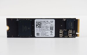

What kind of NVMe drives does this support? PCIe Gen 3, 4, and/or5? Or what gen drives can I use? I will use this with a MacBook M4 Pro if that makes a difference.
It says PCIe 4.0 on the second image of the shop link you provided, and it's an nvme m.2 with the "size" 2280. What you're looking for is something with this form factor and pins

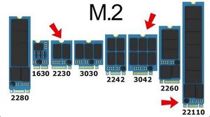

It supports sizes and I quote "2230, 2242, 2260, and 2280mm"
The likelihood of buying older or smaller form factor units is next to 0 in the US and EU, I know because I spent 2 hours shopping for one yesterday.
Here's the various sizes of M.2 SSD's:
