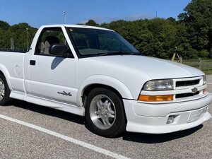

The 1999 Chevrolet S10 Xtreme was a factory-produced sport truck package. It features a lowered ZQ8 performance suspension, aggressive body styling and model-specific 16-inch alloy wheels.
