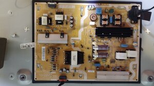

TV will not turn on.Red led power sensor flashing code
Television will not turn on. Why does the red led sensor light appear to be giving a flashing code. The led will light up for approximately 3 to 4 seconds then go out for approximately 15 seconds and keep repeating this cycle? Tried different outlets, different cords, 60 seconds without power holding the power button and tv will not turn on.

To see if your power supply (as well as your backlights ) work, do this. Disconnect the power supply cord. Remove the back cover. Disconnect the main board from the power board. Now plug the power supply cable into your TV. Your TV's backlight should turn on. You can see this through the multiple holes in the back of the sheet metal which covers your LCD screen.
If you have no backlights you will need a multimeter and measure the minus and Plus voltage pins on the main board connector. If there is no pin voltage then the issue is your power supply.
A backlight tester will only turn on the backlight array but it will not tell you if you have any LED's on the array that have failed. Your Samsung TV uses a current resistance circuit that will prevent your TV from coming on if there are any LED's that have failed. I use my backlight tester to check the array to identify which LED has failed when I have a panel disassembled. Or to verify that the backlight is just not turning on. Commonly, Samsung TV's will give you a 6 blink error code if it is the backlight.
IF you are unsure about any of this, just unplug your TV and remove the back cover. Then take some good pictures of the circuit boards and the interconnect ribbon cables. That way we can see what you see and provide further assistance with this.

Just an update. I couldn't wait to check out what you had instructed me to do oldturkey03. The LEDs do light up when main board is disconnected from power board and power is supplied.

@chancez perfect, that means that your backlights are working. Now you would need to measure the voltages on your power board where the main board connects to. Check the standby voltage. Not sure on your board but it usually says something like ST_BY or similar. You will have to do that with your TV plugged in and all boards connected. Make sure you do not touch the power supply since it will carry household voltage :-) It'll be VDC and should be somewhere in the 5V range.
Looks like your power supply is a Samsung BN44-00808E and on that one the STB voltage is 7.5V and when you turn on the power it goes high to 11.5V There is a jumper close to the connector that you can use to check the STB voltage.
