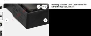

Hi @wearingthepants
The part number is usually found on the part itself if you wish to verify by checking the part number on the original door lock in the washer, that it is the correct one, before ordering it.
Here's an image that shows where to look
(click on image)
