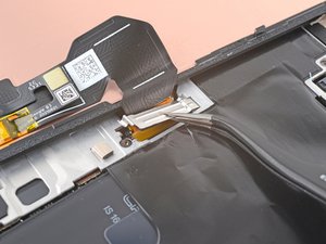

Unlike my Pixel 6 Pro, the screen connector on your phone is held in place by a clip using tension rather than being screwed down like my 6 Pro. So after a fall, it is quite possible the clip could have popped loose, allowing the connector to disconnect, if only partially. Here's what your connector looks like.
Outside of restarting the phone, and possibly restoring it to factory settings, that connector is really about your only hope. If it's come loose, you should just be able to pop it back in place and be good to go; otherwise the next step is definitely going to mean replacing the screen.
Google Pixel 6a Screen Replacement - iFixit Repair Guide
Follow the guide up through Step 16 and disconnect the screen. Examine both sides with a magnifying glass and bright light to make sure there are no bent, broken or missing pins. If it all looks good, clean both sides with 90% or higher concentration isopropyl (rubbing) alcohol, give it a minute to dry, then reconnect and test to see if it's working.
