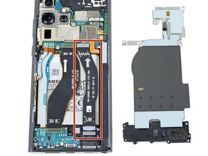

The bottom half of my S22 Ultra has been flickering. In my attached picture, you can see that the bottom half of my phone is dim. My phone will flicker between dim and normal.
I'm guessing that a connection somewhere inside the phone is loose, so the bottom half of the display is not getting full power.
If I open up my phone, is there something I could check with a multimeter? Is there a part that I can replace that will likely fix this issue? For example, I notice that AliExpress sell replacement cable parts like these. How would I go about determining whether say the LCD cable is the defective part?
Or is there a connection that I can check with my multimeter and then fix via soldering?

There is a (replaceable) cable connecting the screen to the motherboard that could theoretically be the source of the problem. To get to it, you'll need to remove the back cover and the wireless charging coil. Follow the screen replacement guide up to Step 19, at which point you'll see the flex cable in question.
Samsung Galaxy S22 Ultra Screen and Battery Assembly Replacement - iFixit Repair Guide
Unplug the connector, then check both sides on each end for any bent, broken or missing pins. If everything looks good, clean all four connectors with 90% or higher concentration isopropyl (rubbing) alcohol, give them a minute to dry, then reassemble and test.
If messing with the flex cable doesn't help, my next step would be to go ahead and replace it. Although it's extremely rare for a cable to fail, the next step after that would be to replace the screen, so I'd try the cable first since it's going to be cheap. If that doesn't help, you're pretty much left with having to buy a new screen, as it's almost unheard of for the GPU to fail on a phone; by far 98% of issues like you're describing are going to be caused by a failed screen.
When shopping for a replacement part, try to find one that allows returns. Most vendors will take a screen back if it hasn't been installed; all you have to do is open up the phone as I've already described, then unplug the bottom end of the display flex cable and plug it into the new screen. Power the phone up and verify that the problem is gone. If it is, go ahead with replacement, and if not you can then return the screen.

This is an amazing answer. I will try everything you recommended! I've already ordered a new cable I could try. It should get to me in a week. I will keep you updated on how everything goes.

Hi, Jerry, I just wanted to come back and give you an update. I did replace the flex cables (main, LCD, and signal) but the display still didn't work. I ended up just replacing the display. Thank you for the help though. I really appreciate it!
