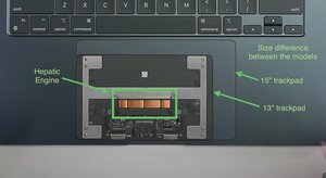

Here's an image of the hepatic engine on the backside of your Trackpad
