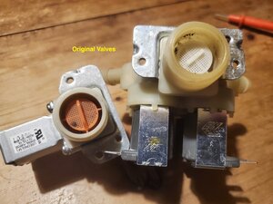

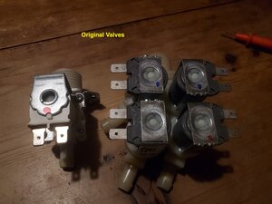

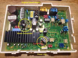

I tested the Power Cord, Noise Filter, Cold Water Inlet Valve, and Hot Water Inlet Valve for continuity. The PC and NF passed, the Valves failed. Additionally, the Valves had a lot of buildup in them. From another post I read, I assume it was melted resin from my old water heater that I recently had replaced. The Control Board has a blown component on it.

I replaced the Valves and the Control Board.

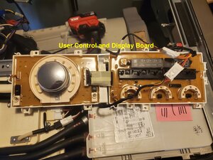

The same as before – the washer will not turn on and turning the tub manually does not cause it to turn on, even momentarily. The replacement Valves did not test positive for continuity, but I went ahead and installed them anyways. There is a light on the Control Board that I assume turns on when it is receiving power, but it is not turning on even when everything is plugged in.
I don't think the User Control and Display Board is the problem since the Control Board is not receiving power. Even if the replacement Valves are bad, that should not prevent the washer from starting. The wall outlet is indeed putting out 120 volts by the way. If the replacement Control Board is not bad then I am at a loss as to what the problem could be at this point.

Edit 1: Out of desperation, I removed the replacement Control Board and tested continuity of the fuse – negative. I'm 99% sure ShopJimmy sent me a bad Control Board! Unfortunately, you cannot just remove and replace the fuse – it is epoxied into place and I do not want to mess with it since it is still returnable/replaceable. I will edit again when I have an update.

It might not have been a faulty replacement control board.
It could be that there's a fault in the machine that causes the fuse on the control board to blow as soon as power is connected to the machine.
Here's the service manual for the model that may help.
There's a very basic wiring diagram on p.17 that shows where all the components e.g. motor, pump, valves etc connect to the control board.
You may have to check that there's no earth (or short circuit to earth) connection on any of the leads connected to the board when there shouldn't be
The 0V for the lamp would be correct as this correlates to the OL measurement on the Test point near the input line filter.
You said that the fuse on the control board was open circuit so if no power on the board there won't be any 16.5V for the lamp either.
If you can't get a refund on the replacement control board, since you now have two controls boards, original and replacement (is this correct?) I would replace the blown fuse on one board and check if it now works.
A partially jammed motor could cause an increase in current to flow through it which may have resulted in the fuse blowing.
Nothing much to lose by trying. If the problem is still there hopefully the fuse will just blow again
