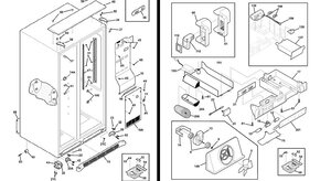

I don't know. I think it must be somewhere inside the refrigerator compartment.
The parts diagram isn't that explicit. It is part # 50(241509101)
(click on image)
thanks jayeff - i am trying to find out where the controller board is

can you please guide on how to locate it
I took the backcover by the compressor but could not find a controller board there. Instead I found a bunch of cables coming from inside the refrigerator compartment - see below
https://imgur.com/a/060TpfK
Where is the controller board?
@jay11813
Most probably behind the control panel at the top inside the refrigerator compartment
