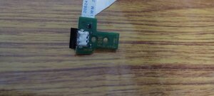

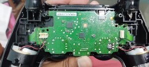

I connected my DS4 to a wall charger, it blinked once (orange) and it stopped and after that it would not start nor it will charge I tried things like reset button but nothing works. After loosing hope I showed it to some repair people and they said the controller is dead and since it's a V1 controller repairing is not possible and it just broke my heart as this is one of my first purchase after getting my first job so I have a lot of memories attached to it, can anyone please help me out regarding what should I do and all, I have attached some of pictures so it could be helpful. The charging Port is JDS-030 and I see TH201 on the motherboard.

Just to check.. did you tried another battery? Would try this first before removing or replacing anything else.
If the same issue occurs, then please remove the USB/LED board and replace it.
If the same issue occurs after that, then it is motherboard related. And you might want to check the board.
Please try another battery first and see how that goes!
Thanks for the reply, will definitely try this and If nothing happens I will get back to you here, thanks again!!!!
Alright!! My pleasure! Please let us know how it goes!! Thanks!
