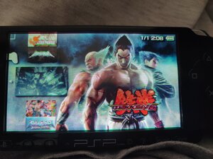

My screen has sideways rainbow lines and screen is purple ish
i want to know if this is a motherboard or a screen issue i wanna fix it

Hey there OP, It sounds like the screen could be damaged. Would you be able to take a photo of the damage so that we can confirm if this is the issue?
I agree.
It does sound like screen issues. But it would be better if you can share some pictures with us: Adding images to an existing question
Thanks!
[image|3754398] there is a another one its much worse then the picture

Thanks for the pictures! The first photo does indicate screen issues. I would replace the screen and go from there.
The only way to be sure is to test parts.
I would order a new screen and test it!
If that’s not it, then it must be the GPU. But this is less likely the issue here.
Guide: PSP 300x LCD Screen Replacement
Please let us know how it goes!
