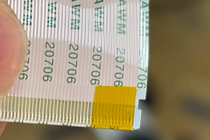

Hey! I've got a Philips 58pus8505/12 that ended up dying on me a few months back. It went completely black but still had sound and ambilights working.
Decided to order a new T-con board to see if that would fix it without success.
I stumbled on a "Tape fix" video, decided to give it a shot. Ended up taping pin 1-13 from the right and hey, it works (with a few picture flaws)
My question is this:
What would be the reason this tape fix works, is it it the mainboard that needs replacing?
Thanks in advance!
The reason the "tape fix" works is because you are physically blocking certain signal lines from the T-con board to the LCD panel that are sending faulty data.
When one or more gate/source driver lines on the ribbon cable are shorted or degraded inside the panel, they can pull the entire display down, resulting in a black screen. By insulating those pins with tape, you stop the bad signals from reaching the panel. The rest of the panel can then operate, but you usually get side effects such as picture defects (stripes, color shifts, loss of sharpness).
Key points:
Replacing the T-con didn’t help → the T-con is fine.
Tape fix works → the fault lies in the LCD panel’s built-in driver circuits.
The mainboard is not the cause.
Permanent fix would mean replacing the entire LCD panel. Tape is only a workaround.
