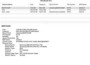

Samsung EVO 970 Plus m.2 SSD's work perfect with a SINTECH adapter. Been running it for 1 year + no issues.
Just ensure the firmware is 2B2QEXM7 or 4B2QEXM7 & you will be fine on MacOS 12.7.6 or Windoze 10 or 11.
I installed it without using bootcamp (There are some videos online on how to do that).
