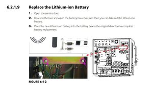

Where exactly is the battery located?
@alecfuhrman should be this one
You can download the service manual from this page Mindray A5 A4 A3 Check under the Documents tab.
