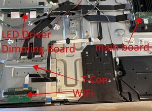

Update:
So I went and disconnected both LVDS cables from my TCON and that caused the backlights to come on and stay on after Power-ON. The screen stayed in a test pattern cycle (colors, black, white, grid) that was fully displayed across the whole screen.
Then I disconnected the power and reconnected the larger (right hand side) LVDS cable and then reconnected power and the screen went to the SONY logo at Power-ON and then turned completely off (no backlights).
Then I disconnected the power and Right LVDS cable and reconnected the smaller (left hand side) LVDS cable and then reconnected power and the backlights came on and stayed on. The full screen once again went into the same test pattern cycle as described above with both cables removed.
Throughout all of this the remote up/down produced sound.
So next steps? It seems like this points somewhat conclusively to a T-con board failure or something wrong with that LVDS cable (or the physical cable connector on either the Tcon or Mainbaord. Suggestions?
Pics below of Tcon cables with Right side disconnected.

It is possible that this is a T-con board error or a panel error. Some panel errors do not trip the Power LED blink code.
Update (08/30/25)
@caig64685 the board I am referring to is the one in the Blue rectangle :-)
Update (08/30/25)
@caig64685 "Everything else looks ok I think" looks are deceiving and you could actually do some testing. Replacing boards willy-nilly can get pretty expensive. You are right, there is no immediate damage visible but we do not know anything about the functioning of the board :-)
Anyhow now repeat this test
  • Unplug the TV power cable
  • Unplug one ribbon cable from the T-con board to the LED panel (driver board) (BLUE RECTANGLE MARKED CABLE)
  • Reconnect the power cable
  • Turn your TV on.
  • What do you see?

@caig64685 post some pictures to point out which ribbon cables you disconnected. For now, this sounds like a bad T-con board. You have a multimeter available?
Pics added, thanks for the link. I do have a multimeter I borrowed but have 0 experience with it and dont have a grounding source / bracelet so I'm hesitant to use it.
@caig64685 you do need to remove the metal cover from the board. You can't properly check the board with it being covered up. Take another picture after you remove the metal cover.
