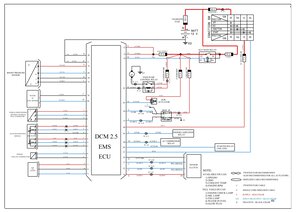

Why is my temperature stop working in my Bolero slx
Bolero temperature stop working how to solve it
@minthangkh47480 what year is your Bolero? What engine does it have?
@minthangkh47480 could be caused by a faulty sensor or faulty gauge. Here is the location for the coolant temperature sensor. It is on the cylinder head
Check the connector, the wiring and you can check the sensor with an ohmmeter as well.
The coolant temperature sensor send the signal to the ECU which in turn sends the signal to the cluster temp gauge
