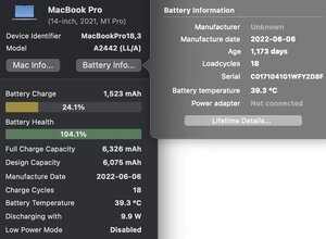

After replacing my old battery with an iFixit kit battery, when my battery goes low enough in charge for the MacBook to go to sleep, sometimes the battery history in settings will completely reset. Is this normal behavior?
Update (08/22/25)
Here's an album with what CoconutBattery shows, the macOS settings's battery tab, and system information's battery tab: https://imgur.com/a/TpgLevK.

That does sound odd! Let's see what CoconutBattery shows us take a snapshot of the apps main window as well as the maOS Battery health window opened up posting them here so we can see things
crwdns2944067:012crwdne2944067:0:
@lonegamer - the only things I see is the battery temp is quite high running at 39.3 Celsius 102.7 Fahrenheit!!
Presently the system is not even charging, make sure t]you get it under charge at the batter is getting low, but at this high temp it's not likely to charge! You need to shut the system down and find a cooler place to charge the system give it a good 8 hours once it's cooled down under charge.
@danj I think my wording made it sound like the battery didn't charge. The battery does charge, it's just that at times when the battery level does drop low enough for the computer to automatically sleep, the battery level history will reset.
@lonegamer - You don’t understand the temperature is way too high! Until the battery temp is below 80 SMC won’t allow the battery to charge which the issue.
@danj Hmm I just double checked after letting the Macbook sit for a bit and it seems like the temperature reading consistently remains high even when the trackpad and SSD report lower. Also just noticed that when the battery history does reset, upon first boot the date shows up as April 1st and resolves itself when I login, presumably after it connects to a server.
@lonegamer - what is the charge on the battery now?
