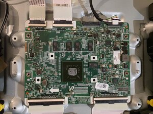

@klauskamberaj do you have a board number or any other identifying markings on board #2? If not, can you post a close up (very close) so we can identify the markings and components on the board? We can get you to check some voltages on the board and hopefully that gives us a better idea. So far it all points to board #2 if it get's the proper signals.
Sure. I attached it. The model is bn41-02492

@klauskamberaj that confuses me slightly which may just be due to my age :-)
Just to make sure we are both on the same page. TV on, Black probe to ground and Red probe to either point of the fuse. You get 30VDC on one and 12V on the other?
Now just the last clarification "when i disconnect the cable that goes from the TCon to the board in the bottom of the screen" which cable is that? For Samsung TV's one of the power board tests was to separate the main board from the power board which would then turn the backlight on. That was considered normal and showed that the power board as working normal
So there are 5 visible fuses (pic attached), all of them showing 30v except F9006s which shows 12.5. I tested while main board cable is off, so all the leds are on.

@klauskamberaj that voltage seems to be to low. can you check the voltage on CN9002 BLU on? Test it with the TV off and then when you turn the TV on.
Also check the BLU voltage on the main board CN201 connector. Looks like pin 8 is it.
Sorry i am not able to find the cn9002 pin? It should be a led stripe?
sorry I meant CN9002 pin 3 If my eyes are not messing with me :-)
It shows 4.13 after i turn it on and doesnt go down.

So after some more digging i found out that the power to turn on the tcon comes from the main board [red circle]. But there is no power emiting from there.
For now the tcon and the led pannel are not at fault.
Yes, it is common for the main board to "tell" the power board to turn the backlight on. So a faulty main board can be the cause of no backlight. CN1801 also send the 13V to the PWM. Check pin 42-51. I just found the SM for a UE65KS9502T which appears to be pretty identical with your model. It has the listings of all the connectors and what signals they carry etc. Might come in handy to thumb through that. Ue65ks9502t Ue65ks9500t Maybe

@klauskamberaj The confusing part on this is that it stets that if the voltages are low on any fuse, it's the LD board (if you disconnected CN9005 ~ CN9014). In your case, that is a new one and we do need to assume it is a good board. You have no power going to the T-con board. CNT803 on the power board is connecting the LD board and the T-Con board. Now CN911 on the main board would send 5V to the LD board on pin 5. If none of those are present the issue will either be the power board or the main board. Since you have power to the backlights etc. when you dc the ribbon cable from the main board, it is unlikely that it is the power board.

I found 2 fuses shortened in the main board.
Removed them and i was able to give 12.4 volt to the pin on the main board that goes to the t con. But at the moment that i connect the tcon, i have a short again.
@klauskamberaj if this "But at the moment that i connect the tcon, i have a short again." actually blows fuses then the T-Con board would have a short on it. Once you replace the fuse on the main board again, can you measure the ribbon cable going to the T-Con board without plugging it in. See if the main board supplies the voltage up to plugging it in. Disconnect the ribbon cables going to the the screen and then plug it in. if the fuses still blow it'll be the T-con board.
