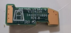

Where can I find a DA00G7TH6D0 E114139 touch screen chip replacement?
I need to replace this chip/board. The connector is broken and the touch won't work. I get results when searching on these numbers, but none of them resemble this chip/board (see image).
TMT YAML 19 94v-0
DA00G7TH6D0 E114139
This is for an HP Chromebook x360 model 14b-ca0036nr
@svohio that is your touch sensor board. HP part number L73317-001 and it is available at places like this (example only, not an endorsement of the seller) and multiple other places
