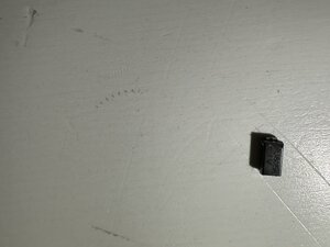

Need help identifying this smd? Even google turns up empty handed

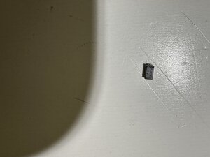

This is the smd in question. Inscribed on it is, pj805k and right under that is IV. Had a short and already changed the mosfet but now the short is coming from this smd
@johndoe42029 your pictures are not quite as revealing as I hoped. If I identified the component from your images correctly (this one
then you are looking at reference designator PD1. That is a P4SMAFJ20A Surface mount transient voltage suppressor (diode). Here is the datasheet P4SMAFJ (1) for that component.
@johndoe42029 BTW iFixit is wat better than Google. We don't need AI; we got a lot of HI (Human Intelligence) on here that beats all the other ones :-)
@oldturkey03 you are a goulds turkey amongst turkeys. Thank you.

@johndoe42029 post a picture of your motherboard marking where this component is actually located
@oldturkey03 I just edited the post with a better picture of the smd and the model of the mb.
@jayeff apologies on the late reply but that unfortunately isnt the model of my mb. It almost was so maybe in the same line different yr? Mine is DAOZHRMB6FO REV F
