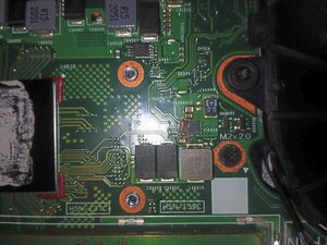

My computer doesn't turn on, only the backlight and the fan at maximum and there is nothing on the screen. I tried with giaa from win + v and this doesn't work for AMD. What can I do?
I've seen this problem in several forums and I don't know what to do. It also has a burned component, but after investigating with Gemini, it has said that it does not affect the boot. I want to know how I can know if my laptop is still alive before changing the motherboard since HP does not respond
@wex17018 just so we understand correctly, "Gemini" suggest to you that the failed component U66610 is not the cause for your computers issue. Do I have that correct? Have you checked the exact model for your motherboard? Your computer is a HP EliteBook 845 G7? If so then your motherboard is most likely a LINDEN-6050A3147201-MB-A01 and schematic are not yet available. We will need to see the failed IC (well focused close up picture) and we need you to tell us if there is any writing on the IC so we can try and identify it.
Hi @wex17018
Did you try a full power refresh i.e. disconnect main battery and RTC coin cell battery from motherboard, press and hold power button for 30 seconds then reconnect RTC and main battery and check if it turned on and passed POST, you never said?
@jayeff Disconnect the coin cell battery for 30 minutes , after that the keyboard stopped lighting up
@oldturkey03 That's right, this happened shortly after trying several things to get it working again. But it's still the same and I don't have another board, the component is unreadable :(
