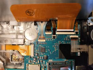

Hey, thank you! Here is the photo of screen connection:
Thank you! The middle connector (next to the display connector) is loose and not connected. Are you aware of this? If yes, can you post a photo regarding the complete motherboard? Thanks!
Thank you so much! No, I'm not really aware. Just to clarify — do I need to post a complete photo of the top of the motherboard (the part that's covered under the screen), or should I disassemble the console and post photos of the motherboard from both sides?
Please connect that one as well and see if it works afterwards! Otherwise, yes please disassemble it and sent pictures regarding both sides. Thank you!
