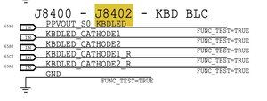

Hello,
I have the intel 2020 MacBook pro 4 tb3 model.
I bought the casing and have now realised this cable is cut/ripped, the MacBook does power on but I’m wondering what this connector is for as I can’t find any information online
Sticking my neck out here and going by the schematics we get
J8402 KBD BLC - Keyboard Backlight Cable?
Maybe can be confirmed by @danj
