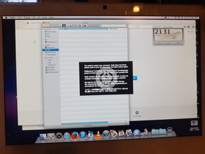

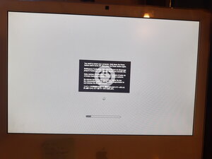

standing around, powered up, probably asleep, when it started to boot and reboot and reboot, but not the whole deep "BONGG" but a cut-off "Bong...Bong...". It kept repeating until I shut it down with the power button. I managed twice to get it in Target Mode, but it froze up, after a while, both times. I once got it to boot almost all the way (got the desktop picture), then it froze. Another time, I got almost all the way, then Kernel Panic, turn off and on again, and the amputated short "Bong"-cycle again. gave up on it, tried again today, with a PRAM reset (maybe I let go too early?), a Verbose (no response) and a "SHIFT", which gave me a progress bar, that came maybe 1/10 of the way (about 1 centimetre was gray) and then Kernel Panic again.
Just before this, possibly after the Parameter RAM reset, I got a "normal" boot, all the way to desktop, clock and date, and the startup window of Firefox (I had a full Finder window opened before FF laid itself over), and everything was there, and then, the Iron Curtain came down: Another Kernel Panic.

While other devices haven't suffered from the cold it's still likely an issue here. I would at least check the capacitors, follow this guide to get to the power supply iMac Intel 20" EMC 2105 and 2118 Power Supply Replacement look for bulging and leakage. Reference the Blue URL link I provided to see examples of failed capacitors. This system was within the years the bad capacitors were flooding the market.
I would also remove the RAM and wipe the contact surfaces with a fresh pencil eraser to clean off and tarnish. As this is an older generation parts and even software are getting hard to get. Do you have the original OS disks? You may need to replace the hard drive and will need the OS disks to rebuild things.

@cieludbjoerg - Your iMac's hardware is not stable. From experience I have replaced quite a few electrolytic capacitors in these older systems as the lack of clean power messes them up.
