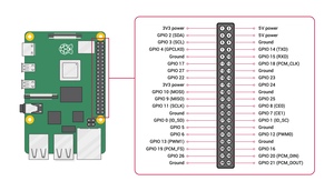

  • Check the voltage rails on the GIPO header pinout is found here
