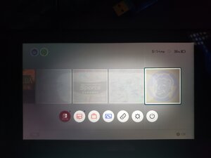

Hi there, this switch seems to have some display issues which I am wondering if someone could help me with. I am planning to open it up this weekend but I would like some prior guidance if possible.
In handheld the brightness is on max but the screen is still very dark. There only seems to be proper backlighting in the very middle circle of the screen?
When the console is playing games everything is very very dark as shown below with Pokemon. There is also a very solid image of whatever has been running for a few minutes prior overlaying everything as well
Apparently, the switch was left in standby in a blanket for a long duration.
From what I can guess it seems like it may be damage from overheating and some major burn in? Would this be an LCD replacement or could I possibly fix this by re-seating a ribbon cable?
Thanks for the help.
This is a comparison with a normal switch:

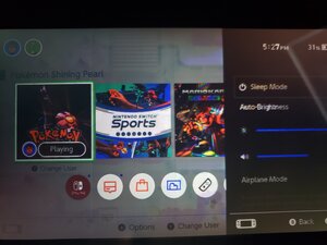

Pokemon, on max brightness:

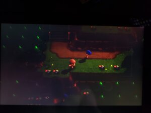

Burn in? After running Pokemon for 2 minutes:
Update 1:
I have a working console, and swapped the LCDs both ways. All screens appear broken in the bad console and all seem to work in the normal console. So I do not think it is a LCD Issue.
'Broken' Screen - Working Switch:
Working Screen - Broken Switch:
'Broken Screen' - Broken Switch:

Hey thanks a lot for the response! I swapped the LCD with a known working one from another console just now and surprisingly the Working LCD showed similar issues on the broken console. When I then added the 'Broken' LCD to the working console was fine. So I now do not think it is an issue with the LCD, I have added photos to my post to show this.
