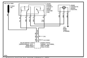

How can i test my Volvo Radiator Fan 1994 volvo estate 850 T5 radiator fan to make sure it is working correctly.
mike, you can disconnect the fan motor plug from the relay, and supply power and ground to the fan motor directly. If the fan runs, you probably have problems with the relay or the temperature sensor. The temp sensor is just below the thermostat in the lower thermostat housing near the power steering pump. The attached diagram show you the wiring for our Volvo> Hope this helps, good luck.
Thank you so much oldturkey 03, the radiator fan is now working
Thank you so much oldturkey 03, the radiator fan is now working,you are magnificent.
Thank you for accepting my answer and you are welcome :-)
