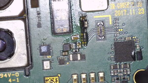

Hello, I have a customer who tried to change their battery on their S9+ but accidentally shorted something. I've discovered that it was this capacitor here in this picture
I desoldered it and can't get a reading on it at all due to it being shorted. Would anyone happen to know the farad rating? I've tried to find schematics for this phone but can't quite seem to ever find this exact one.
thank you
@hoyschelsi78105 the part number for the component with reference designator C4037 is 2203-007781 which is a 22µF-10V ceramic chip capacitor. As for the package size, simply measure the old one or measure from solder point to solder point.

The capacitor is component ID, C4037 as shown in the image below.
Unfortunately the troubleshooting guide from the service manual, which also has the board layouts doesn't include a parts list of the components on the board.
(click on image)
If you can't find the parts lists for the boards (I couldn't) then perhaps an option is to try and find a faulty mainboard and use it as a donor board for components. If you're really desperate here's an option but you may consider it as too expensive just to source a capacitor.
