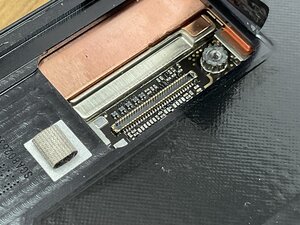

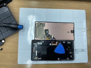

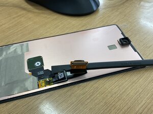

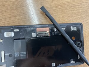

EDIT: some pictures of the connector:
Can you post a quality pic of the connector on the board without the cable attached?
@nige56 I've added some pictures of the connector. Thanks for your response

Disconnect the reconnect the screen connector ensuring it is seated correctly. Connect the charger to the phone and see if the screen shows an image. If not it's either a faulty screen or damage on the board around the connector depending on how it's been disconnected.
