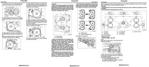

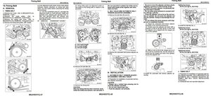

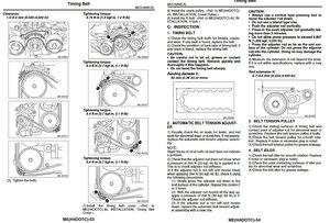

You may have to check that the timing chain has been installed and adjusted correctly.
It's only got to be out by 1 tooth for a piston to hit a valve - see 2nd image (p.50→p.51)
Only got info about the H4DOTC engine (not the STi) which is used in a 2005 WRX, but it still may be of some help.
(click on images)
