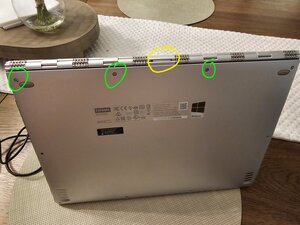

My display has been acting weird for a while but now it flickers in and out unless I put pressure on the key board by the hinge for the screen (shown in video).
Everything else is working normal. Side note as I'm typing this I noticed a lot of flex by the hinge and that I'm missing multiple screws for the laptop. I'm going to try replacing them and see if that fixes the issue
It was in fact the missing case screws. I'm assuming they allowing the case to flex which was messing with the display connection.
I simply took some existing screws and made sure the case was properly secured around the hinge and voila. No more flex, and no more screen flicker. Ordered replacement screws to fully secure the case.
