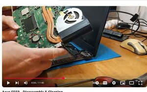

The cmos battery is located on the underside of the motherboard. You have to remove the motherboard from the lower case to be able to remove/replace it
Here's an image taken from this teardown video showing where the battery is located on the board.
(click on image)
