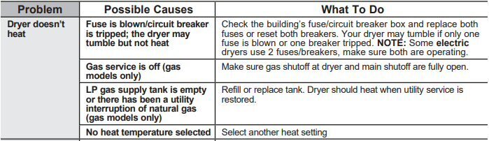

Here is what the manual has for troubleshooting your problem, but it has nothing about the dryer turning off after a little while.
That makes me think that it could be the temperature cut-off sensor/s (image - 506 and 507) being faulty.
