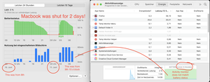

@danj So I have updates with a short temperature log. The basic sensors will always show 31 Celcius, no matter what (in any program, even TGP Pro). The only value which will show realistic data is battery max, which is around 55 degree celcius during loading and between 31 to 37 degree in use.
But I saw that the battery drains power although I tuned of all background activities during hybernation, like tcpkeepalive and others. So even batery status shows wrong data. It is the wrong datum as the computer lost it's power within two days where it was shut completely.
So it actually does not track the battery drain during sleep mode and that's why it will instantly drop from some higher values to very little ones during use, because the battery tracking in sleep mode is disabled and in use the sensors suddenly recognize the power drop of the battery when getting empty. But it should not drain any power anyway, so this seems to be the broken part?
(The temperatur curve for the week is smoothed, so it does not meet the sleepmode on 10th as it will not meassure anyhting during sleep. At the moment the battery was loading it will start tracking the sensor again an that's why the curve looks like the battery was warm the whole 2 days, which wasn't.)

So the first two metrics did look misleading to me and at least I could grab the battery drainage, now!
This looks like a broken battery, doesn't it?
Especially the "Time remaining" was absolutely not possible at 50% charching level. Considering this range with a normal behavior would result in this estimate. But as this percentage range shows a different behavior it is no realistic guess. Here are the images:

@hirsch75736 - This is only part the story! What was the system doing and the temp. All three need to be collected within the same window of time.
Did you get TG Pro installed?
@danj It was at sleep for 10 hours. Than I was just opening the case and reading some news sites in the browser. There was nothing in the background. It resulted in 43% of power consumption for browser. 24% for Mail, the rest for usual system apps. There was no heat.
I'm sure it somehow deals with the periods in sleep mode. It seems like the systems thinks, there is no power usage of the battery, but actually there is.
When I use the battery in one period, say 4 hours, no problem with the battery. But when I use it for some days with long periods of deep sleep in between, it will always result in a power drop when the battery shows a wrong higher level and has actually only 10 percent left, because there was power drain during sleep which is not recognized by the system.
