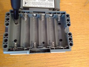

So the batteries leaked, corroded the battery terminals, and a few of the springs broke off. Can I replace just the teminals?

You should be able to replace those fairly easily. The one guide available for that device has this handy picture as the first one in the guide.
The spring contacts consist of a spring mounted on a strip of metal that connects one positive end of a battery to a negative end of the next. It looks to me like there are five of those double contacts and probably two single contacts at each end; one positive with a spring and one negative.
With the exception of the two end contacts, those terminals just pull straight up to remove them. You can buy replacements quite easily on places like Amazon among others. Here's a picture of what you're looking for.
This is just the first example that came up; you'll need to measure yours and compare them against the sellers descriptions to find one that fits.
Amazon.com: Cutelec 10Pairs Battery Springs AA Battery Negative to Positive Conversion Spring Contact Nickle Plated 12x12mm and 12x26.5mm : Health & Household
Thanks Jerry, that’s really helpful. The key for me was “those terminals just pull straight up to remove” - I was too tentative :-)
