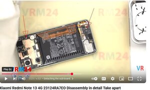

My wifi is not working properly
sometimes it disconnecting to the wifi or it indicates that no wifi connection but my wifi is working properly
Hi @leimalimban
Try using the phone's WiFi as close as possible to your home network router i.e. <15cm and check if the WiFi detects, connects and maintains the WiFi connection OK.
If it works OK, then it may be a faulty antenna/antenna connection that is the cause of the problem.
Here's an image taken from this teardown video of the phone, showing where the antenna is connected.
(click on image)
