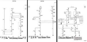

has gas but no spark help please
cars crank and gets gas sprayed into the cylinder but spark dosent happen the coil packs connector aren't getting anything and I have tried just about everything expect go wire chasing and I need it running and driving in 3 weeks please help
@ralover follow the diagrams provided by my colleague. Most common issue is the crank shaft sensor. Remember that both crankshaft angle sensor and cam position sensor have to work. If one of these doesn't, your lancer will not start and there will be no spark.
Hi @ralover
Here's the wiring diagram for the ignition circuit for a 2005 Lancer that may help.
(click on image)
