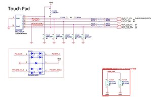

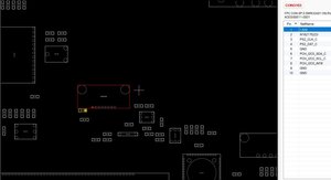

hello. i have an ASUS GL553 touch pad i need to know which pins are Vcc , GND, SDA , SCL I am trying to connect touchpad to usb port via I2C to USB converter would you please help me with that?

@bahman37430 you are not giving us much to work with here:-) I assume your motherboard is a GL553VD. Here is what you are looking for on the board. First your Touch Pad connector is CON3103 and pin 1 is the one marked in red
Next is the schematic that shows the voltages for your touch pad
