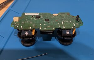

Hi!
Stick drift can only be repaired by replacing it!
Note, that you do need soldering skills to replace it, it won't be easy.
While you are there, I recommend to replace them for Hall-Effect joysticks straight away when one of them is defective.
Guide: DualSense Joystick Replacement - iFixit Repair Guide
If you need any more information, please let us know!

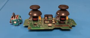

Contact cleaner. DeOXit is the one I use most often.
You dont need to replace or solder anything. Take the controller down to the point that you can take the sticks off. Pull them off. Blow a quick spritz of deoxit into the middle of each assembly, waggle the stick around a bit, wipe/blow off the excess, and there you go.
I have no idea why everyone seemingly forgot this around 2015 or so. Analog controllers have been the same arrangement of X/Y potentiometers since like 1950 something, they have always gotten dirty, which manifests as "drift", and contact cleaner has always fixed it.

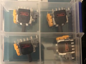

Replacing the stick modules is the only permanent answer. Fit hall sensors instead of the original mechanical ones. You can only clean the mechanical ones once or twice as it doesn’t fix the worn out parts. I just replaced the sticks in my four controllers for Hall effect ones and to be honest they’re better than the originals.
